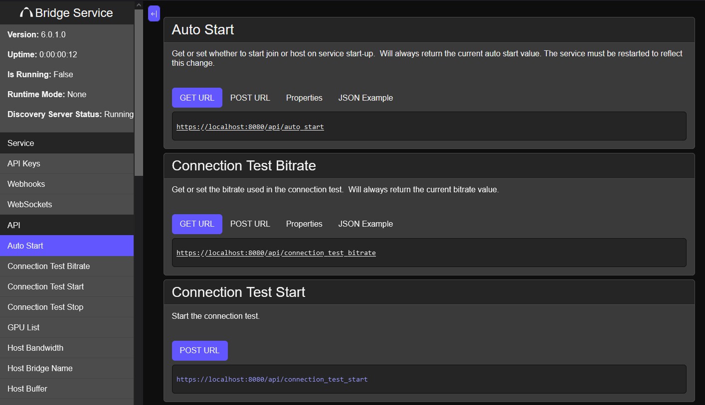

The NDI Bridge Service web page provides an API reference, runtime status information, webhook management, WebSocket management, and API key management if SSL is enabled.

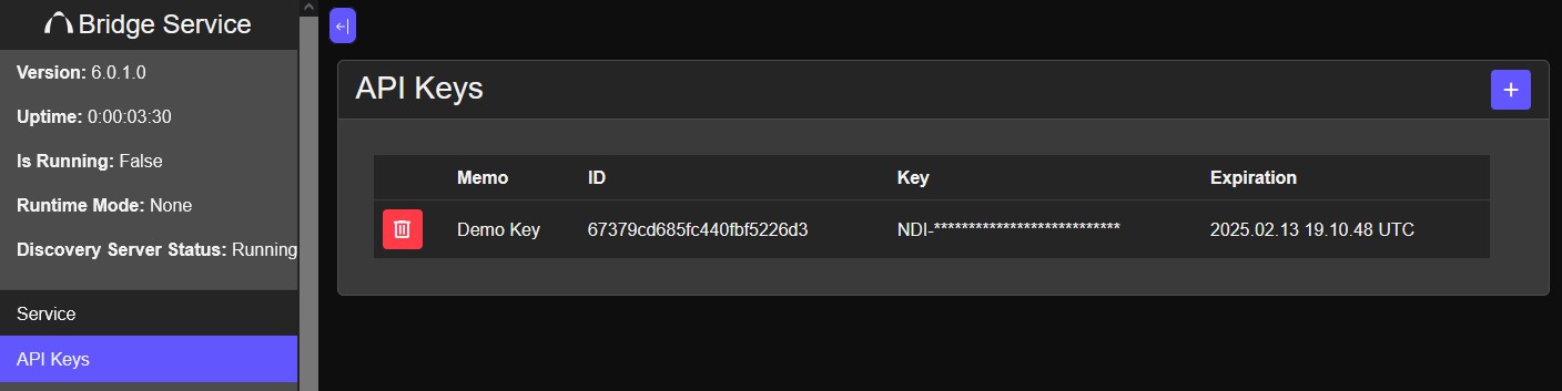

#### API Keys <a href="#api-keys" id="api-keys"></a>
If SSL is enabled and properly configured, you will see an **API Keys** section on the left-hand navigation menu. On this page, you can add and remove API keys required for accessing the API when SSL is enabled.

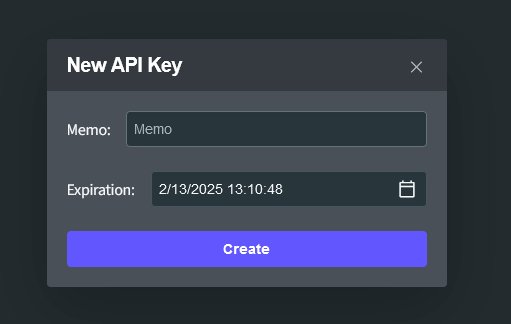

To add an API key, click on the add button in the upper right-hand corner of the API Keys section on the page. You will be presented with a dialog where you can add a memo to help distinguish the purpose of this API key and set an expiration date.

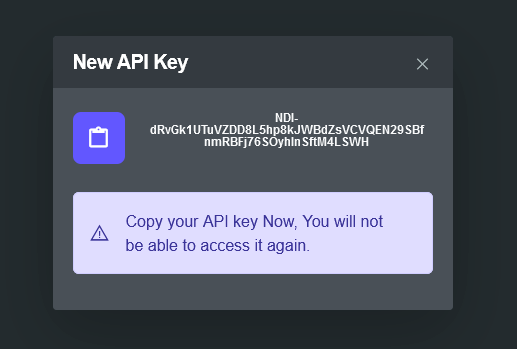

After selecting **Create**, you will be prompted with another dialog to copy the generated API key. You will not be able to retrieve this API key again, so save it somewhere before dismissing the dialog. For information on how to use the API key in a request, see the API section of this document.

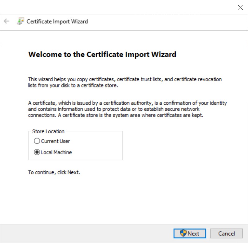

To install an SSL certificate on your machine, simply double click the certificate file to open the import wizard. Be sure to select the ’Local Machine’ option before proceeding.
![Figure 11: Certificate import](/files/HFwsGCOCKOSZbvO5KPni)

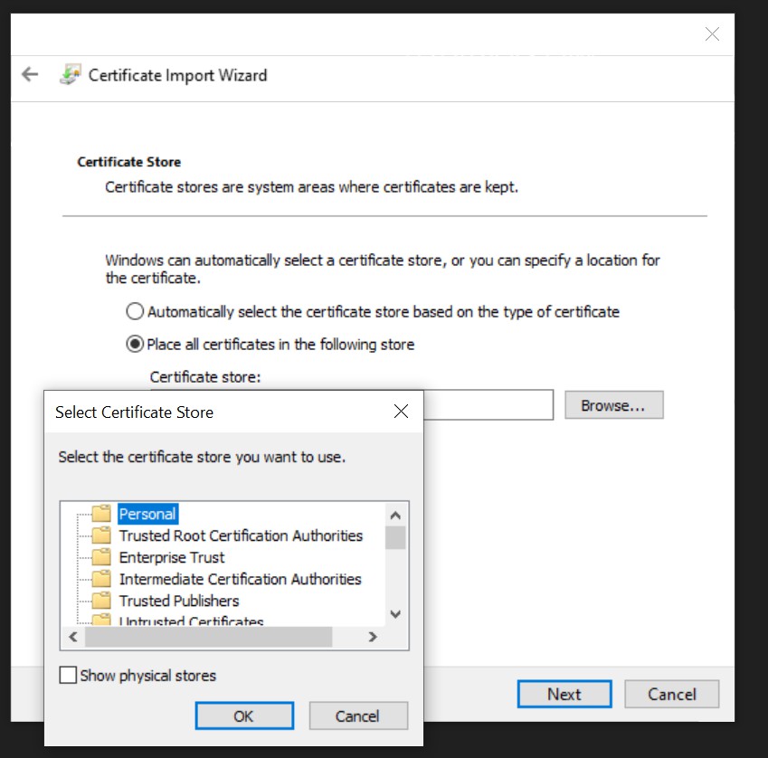

When prompted to select a certificate store, either use the automatic option, or manually select the personal certificate store.

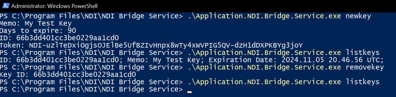

### Manual API Key Management <a href="#manual-api-key-management" id="manual-api-key-management"></a>
If you are using SSL and have the web interface disabled, you will have to use the command line to is-
sue and invalidate API keys. Navigate to the install directory and locate `Application.NDI.Bridge.Service.exe`. This application takes the following command line arguments to manage API keys.
*NOTE:* The service must be stopped before modifying API keys, you can stop it in the Windows Service Console.
* `newkey` This argument will prompt you to provide a memo to help identify the purpose of this API key, and the number of days this key will be valid from the current UTC time.
* `listkeys` This argument will provide a list of all API keys that have been issued.
* `removekey` This argument will prompt you to enter in the ID corresponding to the API key you with to invalidate.
