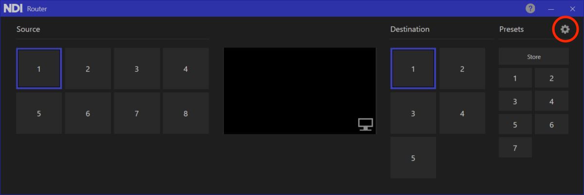

NDI Router can manage up to 64 sources and 64 destinations. To configure it, click on the gear icon in the upper right corner of the application to activate **configuration mode**.
<figure><img src="https://content.gitbook.com/content/DO9LSaUxLOBIgPjyrjR1/blobs/t051zKOpa6O8YvTkGiuY/Router1.JPG" alt=""><figcaption><p>Screenshot of NDI Router</p></figcaption></figure>

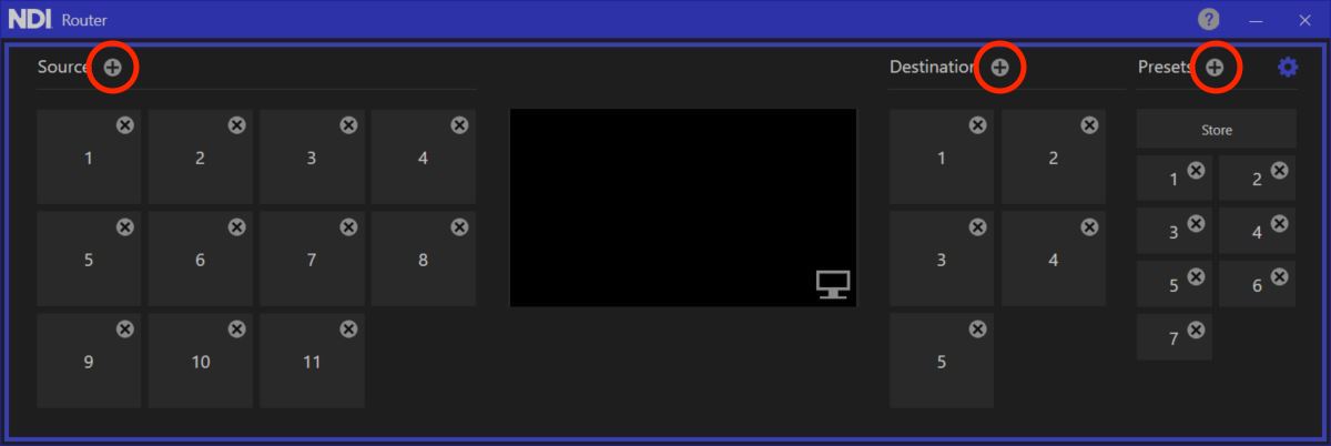

Once **configuration mode** is activated, sources, destinations, and preset buttons can be added by clicking on the icons highlighted below.
<figure><img src="https://content.gitbook.com/content/DO9LSaUxLOBIgPjyrjR1/blobs/9zaaQKIwzXO5iG4O1Sra/Router2.JPG" alt=""><figcaption><p>Screenshot of NDI Router - configuration mode activated</p></figcaption></figure>

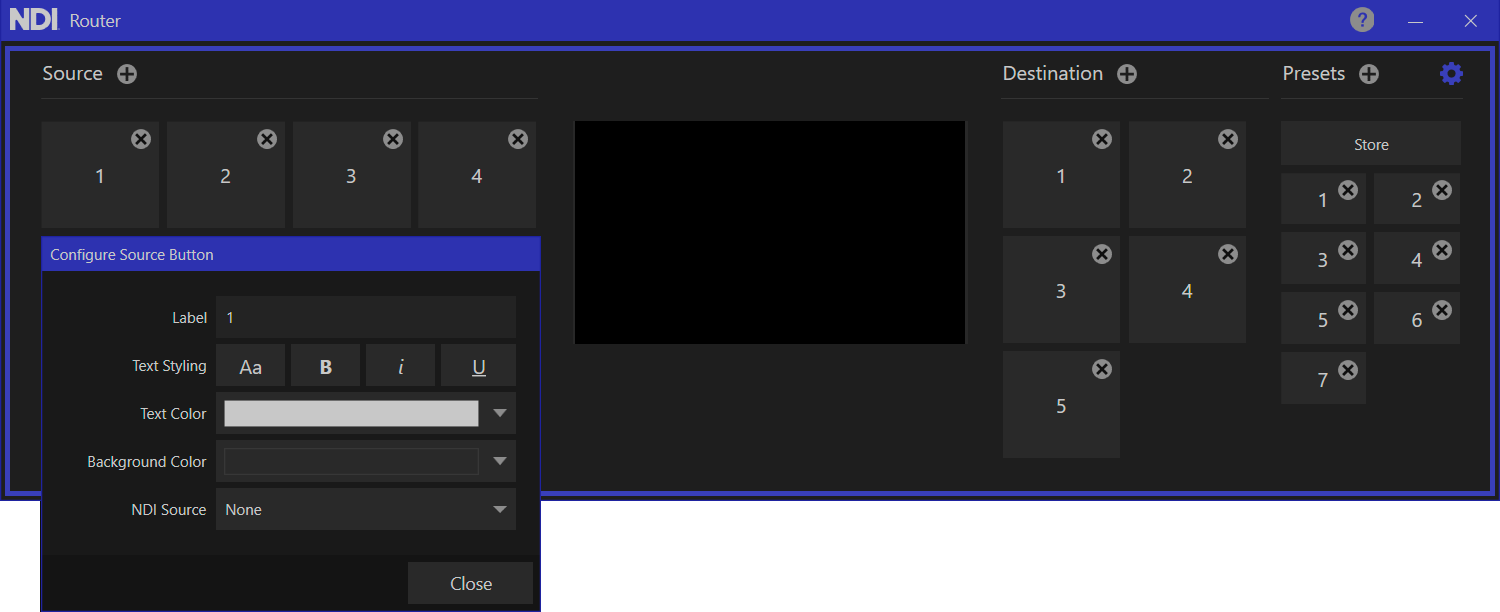

**Sources** can be managed and configured by **right-clicking** over a Source button. In this configuration panel, you can select the NDI sources that will be routed to the destination and define some extra settings like the button label, the text, and the background color.
**Destinations** can be managed and configured by right-clicking over a Destination button. In this configuration panel, you can define the NDI Virtual Stream name that will be received by the destination and some extra settings like the button label, the text, and the background color.
<figure><img src="https://content.gitbook.com/content/DO9LSaUxLOBIgPjyrjR1/blobs/MEQtRXK7RfnX4D4bB7wD/Router3.png" alt=""><figcaption><p>Screenshot of NDI Router - Configure Source button</p></figcaption></figure>
