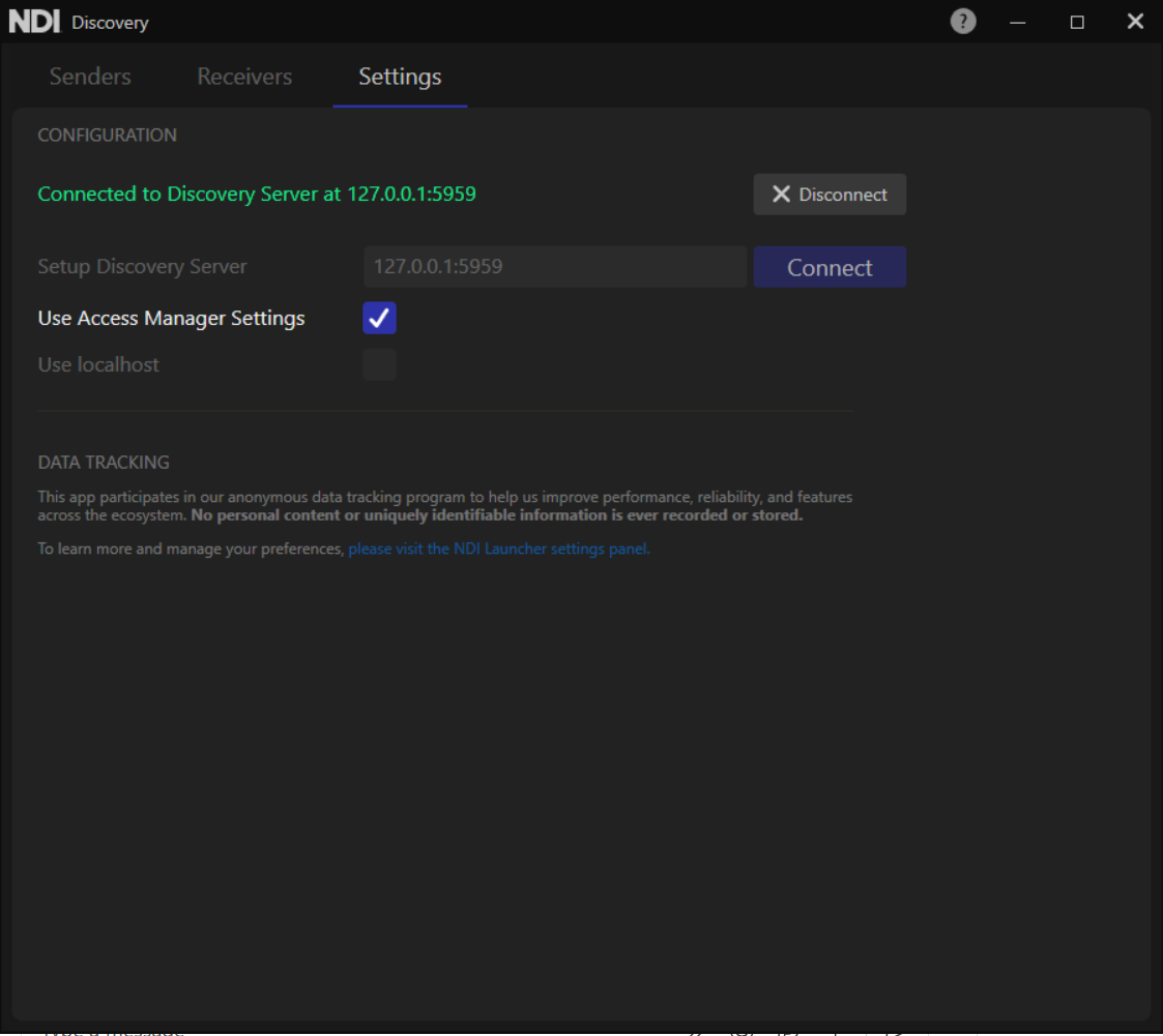

Launch **Discovery** from [NDI Tools](https://docs.ndi.video/all/using-ndi/ndi-tools.md)
1. Go to the **Settings** tab.&#x20;
2. If you configured the Discovery Server IP in Access Manager in the previous step, then you should select and enable **Use Access Manager Setting**s.&#x20;
3. Otherwise, enter the IP address of the Discovery Server next to **Setup Discovery Server** and click **Connect**.&#x20;
4. Just above you should see a message in green saying, **Connected to Discovery Server at** and the IP address and port.&#x20;
<figure><img src="https://3444609009-files.gitbook.io/~/files/v0/b/gitbook-x-prod.appspot.com/o/spaces%2FDO9LSaUxLOBIgPjyrjR1%2Fuploads%2FKX71qFAAlCnFpp2NINjO%2Fimage.png?alt=media&amp;token=87038a3d-c375-4046-b1bb-26ab5dd1061f" alt=""><figcaption></figcaption></figure>
5. If the message is in yellow saying, **Attempting to Connect** then double check your IP settings again. If you think you might have made a mistake with the Discovery Server’s IP address or port, you will need to run the installer again to reconfigure the IP and port.&#x20;
6. Once done, click back to the **Receivers** tab.&#x20;
