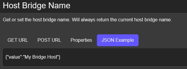

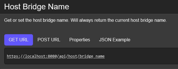

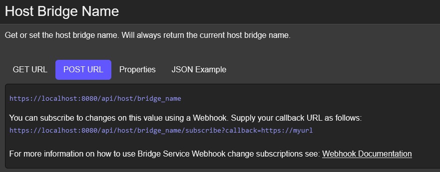

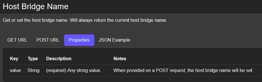

### Host Bridge Name <a href="#host-bridge-name" id="host-bridge-name"></a>
Get or set the host bridge name. Will always return the latest host bridge name.
| Key   | Type   | Description                  | Notes                                                                               |
| value | String | (required) Any string value. | <p>If provided on a</p><p>POST request, the host bridge name</p><p>will be set.</p> |
`GET URL: http://localhost:8080/api/host/bridge_name`&#x20;
`POST URL: http://localhost:8080/api/host/bridge_name`
`EXAMPLE POST CONTENT: {"value":"My Bridge Host"}`
