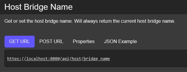

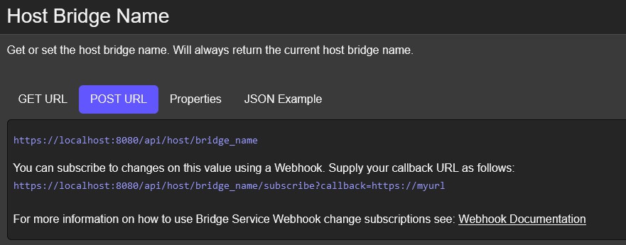

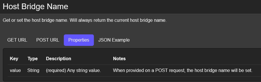

Host Bridge Name
Get or set the host bridge name. Will always return the latest host bridge name.
Key
Type
Description
Notes
value
String
(required) Any string value.
If provided on a
POST request, the host bridge name
will be set.
GET URL: http://localhost:8080/api/host/bridge_name
POST URL: http://localhost:8080/api/host/bridge_name

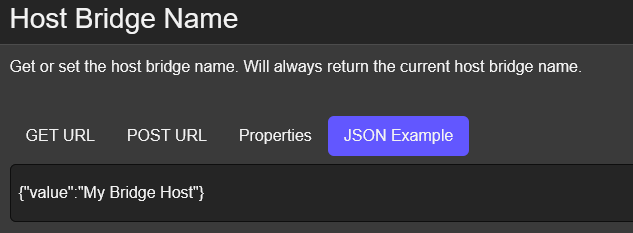

EXAMPLE POST CONTENT: {"value":"My Bridge Host"}
